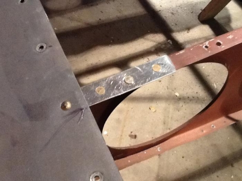

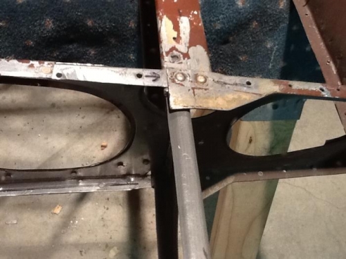

Brief Description:  Began left wing structure repairs.
Began making repairs to top of left wing structure. Fabricated patches out of .032 aluminum to repair wing ribs where they attach to the spar. Installed on two ribs. Drilled and riveted together another rib to rear spar that had apparently not been riveted when an old repair was made. Discovered a crack near the outboard aileron hinge.
Old repair riveted.
Old repair riveted.
Rib attach repair method.
