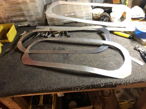

Brief Description:  Tunnel cover, skylight retainers.
A/S order did not come today. Looked at headliner hanging brackets and determined the top of the braces can be moved inboard on the spar (due to shoulder belt attach points) without significant issues. Pulled tunnel cover out from storage and noticed long-term interference had occurred between inside of added-on "bumps" and rudder cable clevis. Pulled out old floorboards and noted nut plates for mounting tunnel cover were not installed when new floorboards were made. Will have to use sheet metal screws or RivNuts in six spots when we install the cover.
Made detailed measurements and fabricated new skylight retainer from .016 aluminum. Trimmed and fitted both new and the one surviving old retainer.

Old and new headliner skylight retainers..
