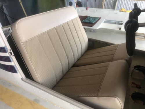

Brief Description:  Left door, seats, panel labels.
On left door: Sanded JB Weld filler and painted. Installed interior panel same as right door. Touched up paint on both doors. Both doors have a few #6 screws that are slightly loose in old holes, may have to be replaced by #8’s if they loosen.
Called Airtex, got instructions on making holes for pins in seatback vinyl. Replaced pin pull string with wire. Installed seatback and seats. Perfect fit, but there is a left and right.
Sat in cockpit, labeled controls with black-on-clear Casio tape, Size 1X2.
