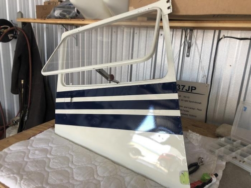

Brief Description:  Finished left door.
Sorted out various sized screws and washers for interior work. Tested old holes, #6 screws seem to fit best.
On left door, riveted latch bracket in place, connected arm to window using 8/32 screws in previously tapped holes. Puttied extra holes from yesterday with JB Weld.
On right door, lined up interior panel and located old holes using hole finder. Installed #6 screws and washers all around. Cut vinyl for door handle hole, pulled back and glued. After consultation with Bill did further disassembly of door handle mechanism and reversed handles to get a downward orientation. Reconnected linkages using small bolt, and secured the big pin with a cotter key. Tested operation. Right door done.
Window  opens!
Window opens!
Interior kit panel looks good.
