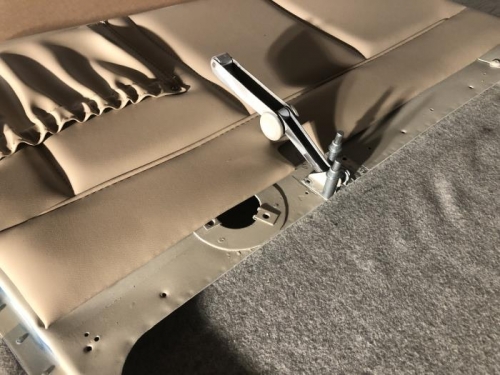

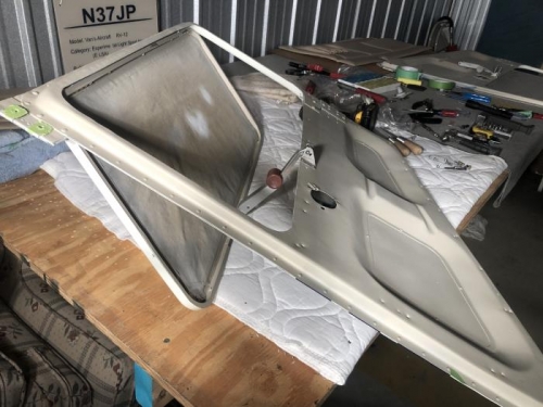

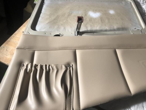

Left door: Reinstalled window by riveting hinges. Discovered window latch has been relocated at some point in past and the notch in the new interior panel does not line up. Drilled out existing pop rivets that held latch bracket to door. Metal behind where new rivets must go is damaged and will require a patch.
Right door: Installed window by riveting hinges. Lined up latch to match new location in left door and existing threaded holes in window frame. The interior panel has not been cut for the bracket, will have to do that ourselves. Riveted latch to door, two pop, two squeezed.
Cleaned debris from insides of both doors.
Need to look at other airplanes and/or call Airtex to get recommended spacing of screws to attach interior panels. Need to look for or purchase matching screw/washer sets as none came with kit. A bag of snap screws did come in box.
