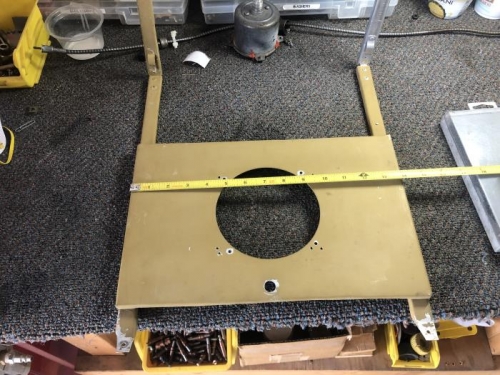

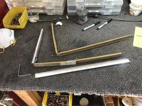

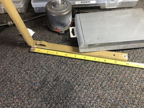

Located old loudspeaker panel and headliner attach braces and clips. Removed panel per IPC Figure 76. Fabricated new channel to replace the old one with the poor repair.
