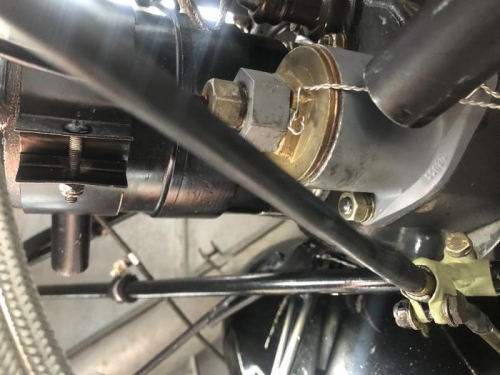

Reinstalled starter. Tested oil temp gauge in hot water, it's dead. Ordered new from A/S. Ran up for oil leak check and to get a voltage reading. 12.4 at 1500 RPM and higher, with very low charge rate.
