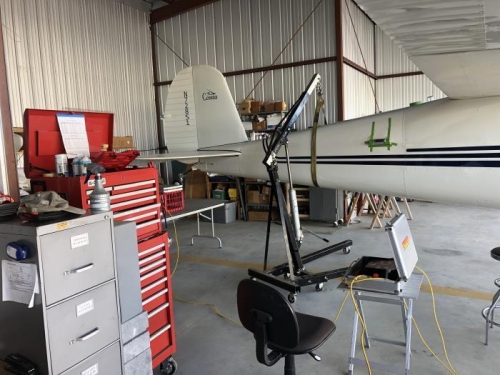

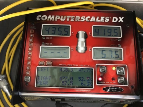

Used Kurt's engine hoist to set up airplane on scales in level attitude. Took weights and measurments, and made calculations per Cessna Weight Computation instructions.
Empty Weight - 911
CG - 14.6
