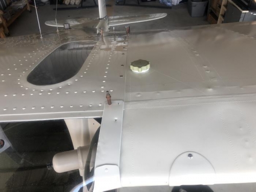

Installed brake clips and cotter keys. Drilled out rivets in wing root areas that had been placed in screw holes. Drilled holes for screws where they had been omittied.
Sam heated and molded windshield edges to conform to fairings. Small crack developed on left side, stop drilled. Barely shows under fairing.

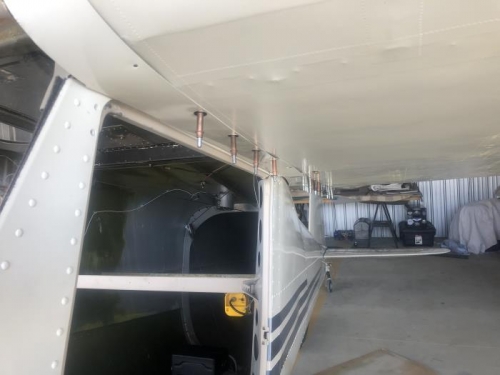

Installed all four sections of wing root fairings temporarily with clecos. Need to final fit, seal around windshield, install screws and washers.
