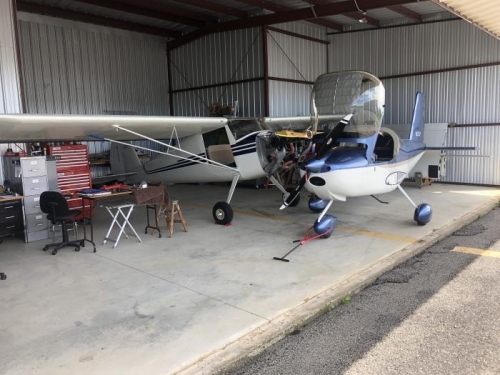

Brief Description:  Moved RV, supervised Jane, did minor tasks.
Brought RV-12 to the T hangar, assisted Jane starting on the annual.
Accomplished a few C120 tasks while monitoring Jane. Match drilled holes from old part and installed fuel selector stop plate and labels. Installed AW Cert. and Registration temporarily. Set tire pressure to 16 psi as specified. Completed the initialization of the TailBeacon. Finished setting up the EI FP-5 by setting fuel low warnings to 14 (first tank nearly empty) and 5 (about 45 minutes fuel remaining.) Safety wired gascolator bowl.
Ed visited, he is wiling to help us experiment with prop vibration when we are ready.
Mentored Jane working on N37JP condition inspection.
