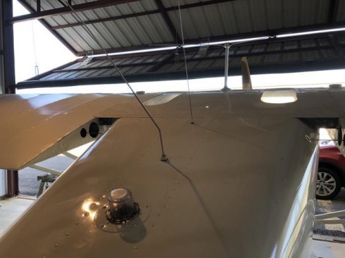

Temporarily taped the “Cessna 120” and” N number” decals on the tail. See photo. Sam helped me relocate the antennas. Tested communications to NY0 Unicom, transmit OK, receive has a hum on the signal. Will have to trouble shoot that at a later date if it persists.

New antenna locations
