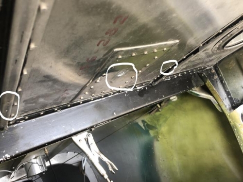

Became concerned that the Com antenna that had been installed in the top of the cabin roof was going to interfere with the new headliner. Researched the DVD and studied the existing holes in our parts that, according to the DVD, are there to support the headliner. Determined that the antenna, as installed, will definitely interfere with the headliner. Determined that one of the support rods that came with the airplane is incorrect material and length. Determined that the set of clips just aft of the skylights are missing. Determined that one of the two longitudinally running channels on the overhead is installed reversed. All of these problems can be fairly easily corrected, with some time and patience. The antenna, however, has to be moved to a different location. Fortunately, there is a previously plugged hole in the skin that can be re-opened and used for the ELT antenna. Then the Com antenna can be moved to the previous ELT antenna location. The extra hole will have to be covered.
Cabin top with antenna hole and headliner clip locations.
