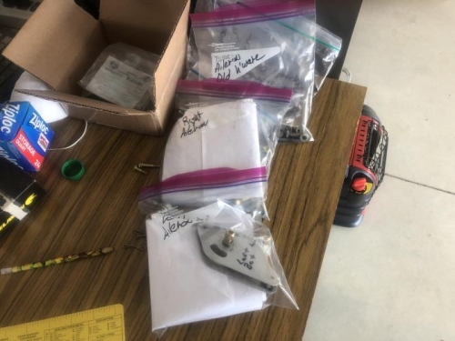

Organized old and new parts for left and right aileron control assemblies, and bagged individually. Lubed bearings and bushings in bellcranks.
Found the old "mystery" parts # 0422300. One appears original, the other a replacement? Gave to Sam for possible reproduction of bolts and bushings.
Ordered three new turnbuckle eyes for the turnbuckles on the ends of the aileron cables.

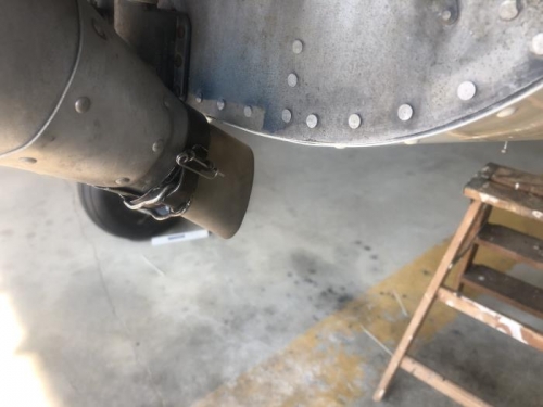

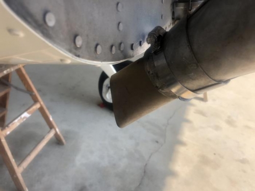

With Jeanne's help and Kurt's lift Inserted one extra washer each side in lower engine mounts, retorqued all bolts. This resulted in adequate gaps between belly skin and exhaust stacks. Now need to confirm no adverse effects on cowl fit.
Aileron parts bagged.
Gap left side.
Gap left side.
Gap right side.
Gap right side.
