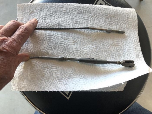

Left side cable ends.
Right side cable ends.
