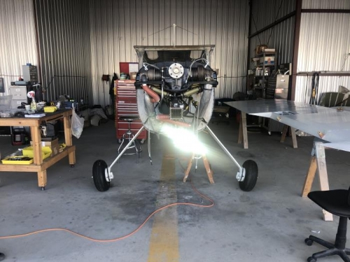

Sam helped me flip wings. Removed excess fabric from all hardpoints. Trried Toulene to dissolve Poly-Brush. Worked but also removes paint - must be very careful with it.
Installed steps. Added 4 quarts of SAE 40 mineral oil to oil sump.
Tested P lead capacitors with Chris' meter, they seem to be OK.
Removed wing strut end from sawed-off strut and set to soak in Miracle Oil.
Reclocked landing light to avoid interference, installed, tested (good).
LED very bright!
LED very bright!
