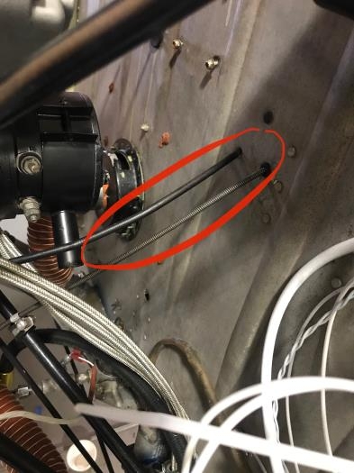

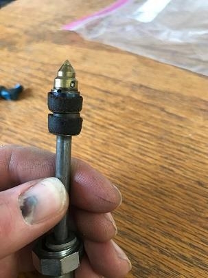

Sam at airport: Presurized fuel system, found bad quick drain valve, ordered replacement. Found that primer leaks, leather packings are deteriorated. Soaking in mouse milk (per Bill). Rerouted mixture cable through new hole in firewall, ordered end connector. Temporarily mounted starter. Looked into sources for rubber fairing seals.
Primer packings.
Primer packings.
New mixture cable hole.
