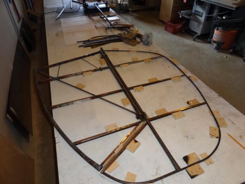

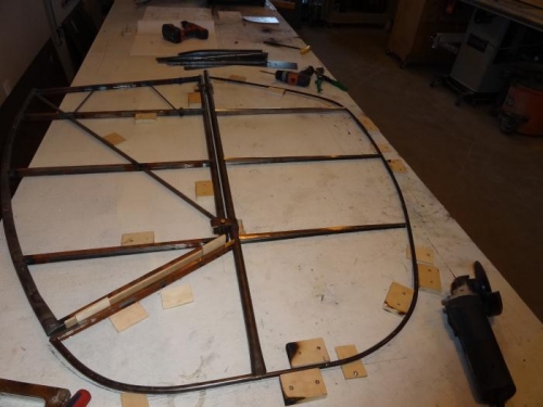

Brief Description:  Left Elevator Counterweight tube and ribs
Here I have made the T-25 elevator ribs as well as the forward piece of tube on the elevator that holds the mass balance counterweight. It is a little tricky bending this piece of tube to ensure that it follows the contour of the horizontal stab as well as meet up the smaller elevator rear tube.
There is a little surface rust on the ribs as it appears it got a little humid in my shop. It cleans right off, though.
Jigging up the left elevator
Another view
Another view
