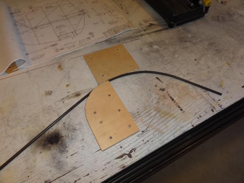

Well, after a 6 month lay off to do about a million other things in life, I got back at it.
Here I have started working on the left elevator. Job one is to bend it. I had laid out the shape in marker on the table top so as I bent the tube bit by bit, I would go over and compare it against the drawing on the table top.
I left both ends of the tube long to a.) help with the bending process, and b.) to give me a fudge factor when it came to trim it to the final size.
Starting the bend
Starting the bend

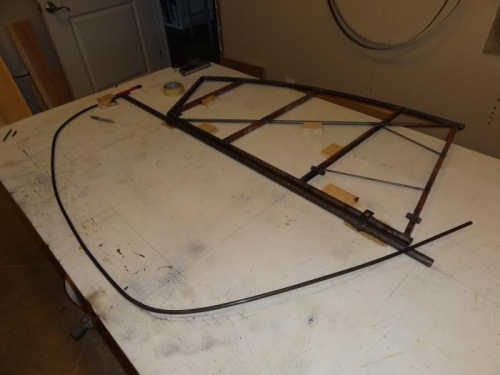

One view of the left elevator tube
Another view
Another view
