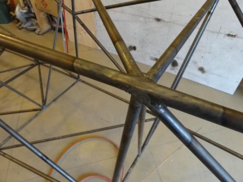

This is the first in what will probably prove to be MANY Fuselage Final Cluster Welding log entries. Estimates range from 40-80 hours of work. We'll see.
The rotisserie makes this job WAY easier.
I'm starting at Station J-H. Each station will be fully finish welded before moving on to the next station. After each station I'm checking to see if the tail has twisted any. I got a scare the first measurement I did. I leveled the fuselage using the cockpit door sills, then stuck a level on the rudder post. It was WAY off!!! Oh crap. Step back, breathe, think about it. I had put the level on the upper part of the rudder post, so I put it on the bit between the upper and lower longerons. it was perfect.
Phew!
I look at the upper part of the tail post and could see it bent a little from the heat of finish welding. I will just reapply some heat to straighten it out and I'll be good.
Crisis averted (for now, at least)
A random cluster to have a picture on the page :-)
