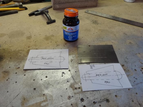

Another long day, but I got everything but the rudder pedal straps assembled and welded.
Apprently I was pretty intent on getting this done because I didn't take that many pictures. I did get a few at the beginning making the rudder cable arms, and a final one. Oh well.

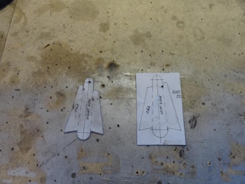

I used full size copies of the arms pasted to the correct thickness sheet using rubber cement. I drilled a hole on the weirdo inside corner to make sure it has a radius, and then just cut them out on the band saw.
When bending them, remember that there is a LEFT and a RIGHT, and they are different.
Rubber Cement

One cut out
One cut out
