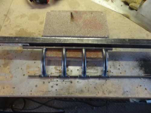

Long day of cuting, trimming, fitting, jigging and welding of the brake pedals and the rudder pedals. I stole Russ Erbs idea of welding the vertical parts of the pedal to a single piece for the horizontal parts, them cut them apart.

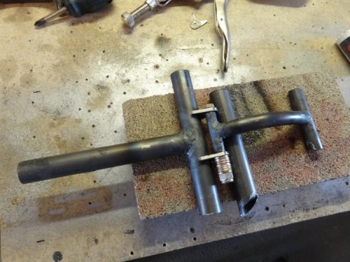

I then made the mounts for the brake pedals that go on top of the rudder pedals. Of course I realized my castle nuts were at the hanger, so I had to use an AN365 to hold stuff together. The nylon didn't last long :-)
Brake Pedal Tops

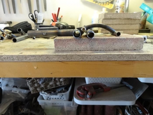

Getting Read to Weld the Brake Mounts
