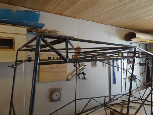

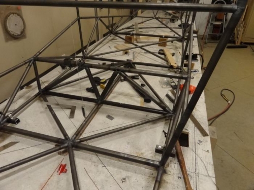

I managed to finish tacking in all of the components of the door overhead structures.

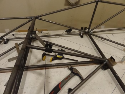

I also got station C-S tacked in. You'll see in the pictures I departed from the plans just a little bit. Rather than usea combination of T11 and T19 tubes across the top of C-S, I just used T19. My reasoning is it is stronger, only a little heavier, and a WHOLE lot easier to install.
Overhead door structure
Front of station C-S
Rear of station C-S
Rear of station C-S
