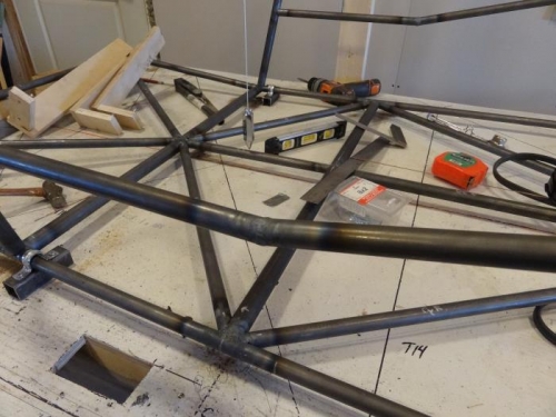

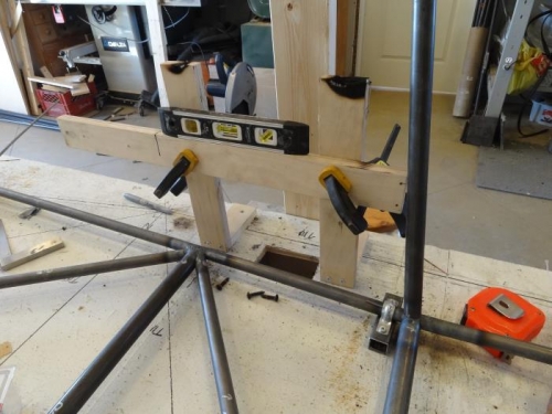

I made a quick jig to ensure I got the forward part of the sill level (picture 1). I also made sure that the jig allowed the door sill to bend out the requried distance.

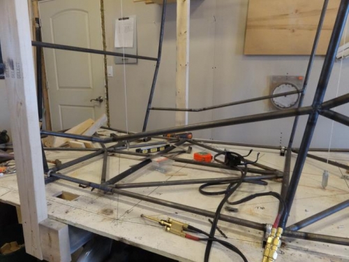

Once I had made the sill itself (including the proper bend), I cut and trimmed the sill to fit in the opening and tacked it in (pictures 2 and 3).
