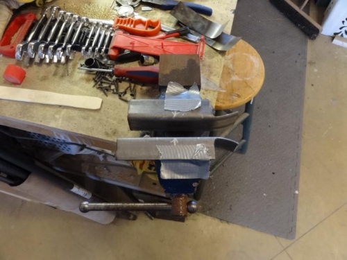

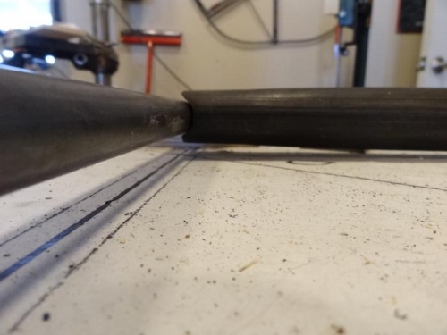

There is a rather large cross tube at the front spar attach point that needs to be smooshed down to match the 3/4" longer ("smooshed" is a highly technical term).
The first picture shows the gizmos I made for the vice that allowed me to gently squeeze either end of the croos tube to the right size.
The second picture is the cross member in question part way through the smosshing process (I don't know why I didn't take a final picture. Must be that alzheim...uh... thingie)
