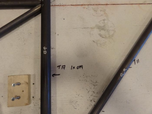

Brief Description:  Laying out bottom crossmembers - Part 2
Measure, cut, trim, fit, grind, fit, grind, fit, repeat ad nauseum....
The first picture illustrates the point made earleir about the intersections of diagonals and longerons.

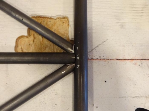

The second picture shows where I labeled each tube for station and direction. I have to remove each tube and drill a hol at the intersection points so I can spread some oil around in side after welding to prevent corrosion.

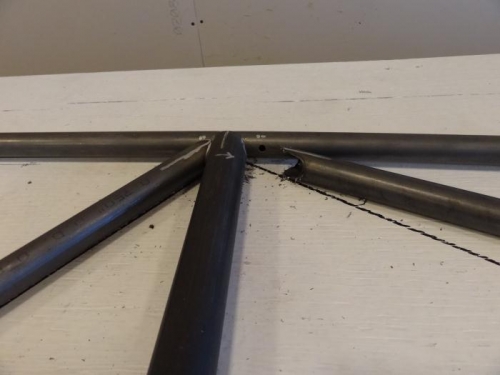

The third picure shows one of these holes.
