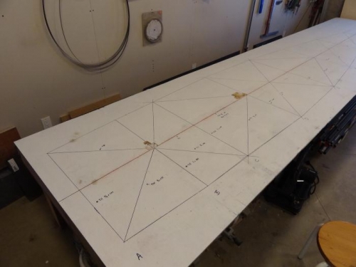

Layout out the fuselage lines
Woo hoo! Pictures again :-)

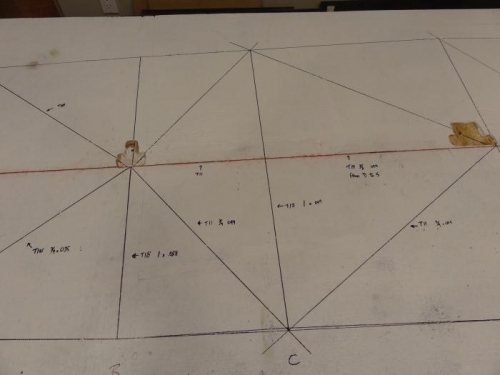

Here I have spent some time marking out he fuselage centreline and all of the tube locations
Jig layout 1
Note tubing callouts

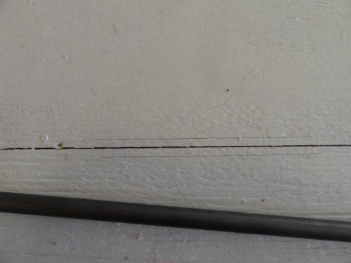

Penciled in sides of the tube
