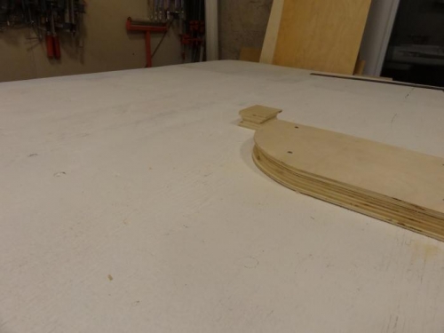

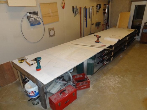

So far I have cleared up the shop, built the fuselage jig table, marked out the horizontal stab on the table top, and made the tube bending bits, so there aren't any more excuses. I do need to pick up some lag screws at Home Dumpo to attached the bending blocks to the table. I'll do that tomorrow.

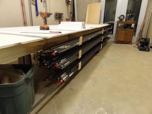

You'll note that I built the table with an overhang, under which I put some angle bracket supports which stores all of the 4130 tube for the airplane.

The fuselage jig
The fuselage jig
Steel tube storage
Steel tube storage
Plywood tube bender blocks
