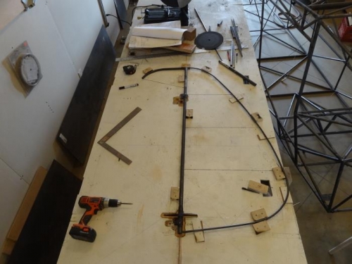

Brief Description:  Rudder - Pt 2
Bent the leading and trailing edges of the rudder itself, and made the rudder spar. The rudder spar is just like the elevator spar so I won't repeat the process here.
I had to route out a little more of the table top to allow the rudder control horn to sit below the surface so the hole rudder spar lays flat on the table.
