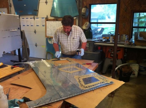

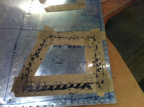

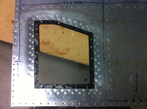

When looking at all the instrument boxes that need to be installed behind
the panel and sub panel access becomed a problem. The only way to get
to anything behind the panel is from underneath. Super pain and very
hard. The decision was made to cut two doors in the front top skin that
can be removed and most all of the instruments accessed from on top.
Friend Don and I spent two full days cutting, dimpling, riveting to get the
doors complete. Will payoff in the future.
