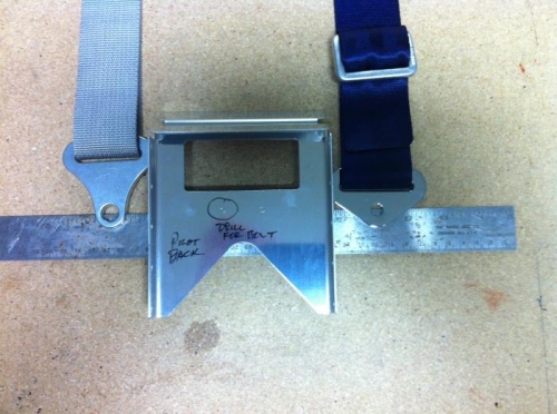

Spent over 1 day installing the 5th point, in the floor, for the 5 point
harness. So with the 5 point harness you have a strap over each shoulder.
Anchor points on each side of hips and the 5th point between your legs at
the crotch. The other straps hold you back put the 5th point holds you down in
the seat.
First photo shows the hardward with old style belt on the right.
The left belt is thicker and well made. Harnesses are from Crow Ind and they
make safety harnesses for all motor sports.

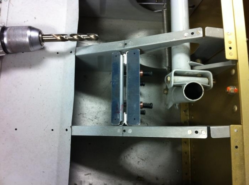

Second photo shows attach point finished. When interior is installed the
short harness will be bolted in between the two plates.
