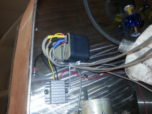

Date:  10-31-2015
Number of Hours:  8.00
Brief Description:  Installed components.
Continued with landing gear lights, breakers, switches, etc. The shower of sparks sytem took a lot of time to wire up. Resistors were required for the Dynon 120 (RPM) and the control box I purchased was a 24v so we had to add a step down transformer for it.
