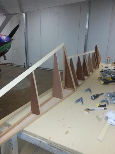

The flap is a singled piece structure that spans from aileron to aileron (under the fuselage). It has a built in twist that must be formed during skinning. The hinges are pinned in place and the frame is twisted to meet the edges of the ailerons.
The rib structure

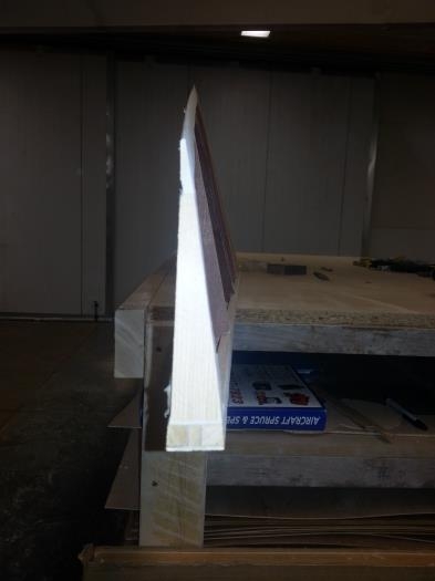

Oversized before sanding

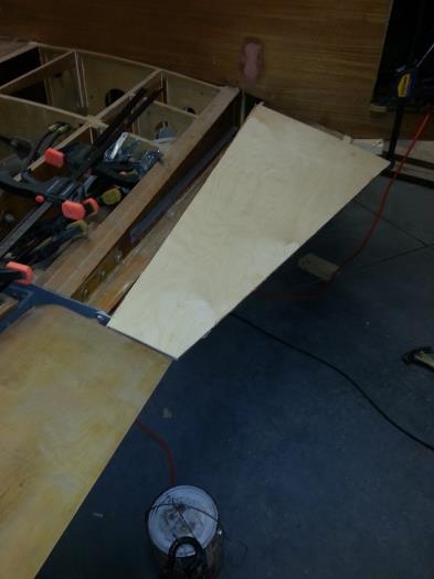

Skinning in progress
