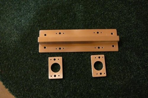

Fabricated and installed the tie down assemblies
Threaded the tie down extruded stock.
Fabricated the spacers.
Primed the parts.
Riveted the spacers to the tiedown stock.
Bolted to the main spars including aileron belcrank mounts.
Main spar prep finished.
Tie down and spacers
Installed
Aileron Belcrank mount
