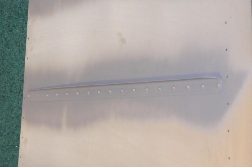

Finished riveting the stiffners on the right side.
Fabricated remaining ruder parts and assembled with clecos.
Match drilled all the holes.
Took it all apart, debured & dimpled everything.
Dressed all the edges.
Ready to prime...
