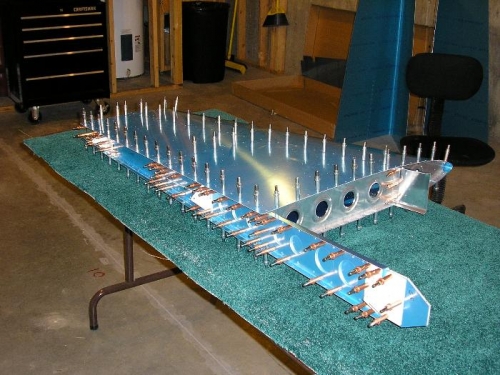

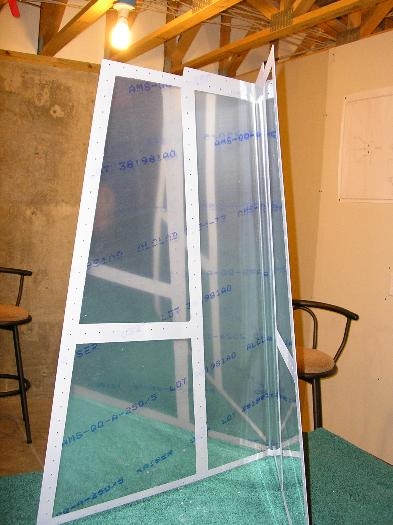

Worked on the vertical stab today. Everything is fabricated, test fit, deburred, dimpled, prime'd and ready for final assembly. I'm only using primer on the inside contact lines on the skins since the sheet is alcad.
Match Drilled
Primered & some rivets
Just the contact lines primered
