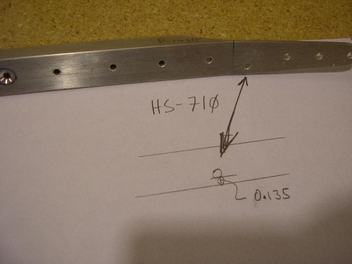

Brief Description:  Worked on the Horizontal Stab
Finished up fabrication work on the horizontal stab, but messed up the last hole I drilled. While back drilling from through HS-405 and HS702 into HS710, I ended up with less then minimum edge clearance on the hole. I've ordered replacement parts (not expensive) and I'll get it right the next time, lesson learned.
I'll move onto the vertical stab while waiting on the replacement parts.
