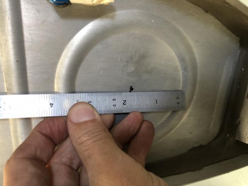

I selected a location for the fuel return line according to EFII guidance.
I marked the pont where I wanted to install the return. I first made a hole using a #40 and using a step drill enlarged the hole to 1/2".
Position of Fuel Return
