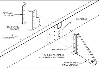

SB 16-03-28: Cracking of wing aft spar web at the
This Service Bulletin is required due to: Cracking of wing aft spar web at the inboard aileron hinge bracket attach rivets.
For RV-3/3A/3B, 4, 7/7A, 8/8A, 9/9A aircraft: being installed during build.
I used this hour to understand wat needs to be done.
You can see in Image 3, the Aileron Attach Doublers in place.

AIleron Attach Doubler
Aileron Hinge Bracket Rivets
Large and Small Doubler in Place
