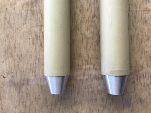

Aileron Bellcrank to Stick Pushrod W-716
I inserted the VA-111 into the end of the pushrod. Given the priming on the inside of the pushrod, this took a little persuassion.

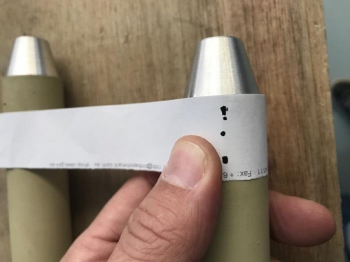

I used a strip of paper to equally measure out the spacing of the rivets and marked these on the pushrod.
VA-111 Threaded Rod End
Spacing the 6 Rivets
Paper template to mark rivets
