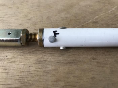

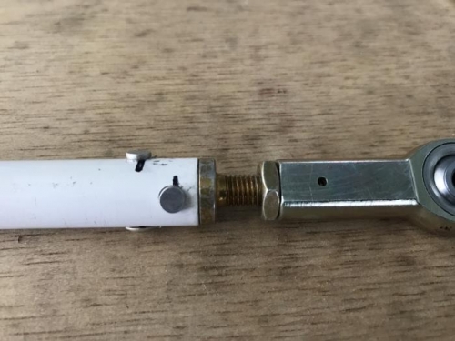

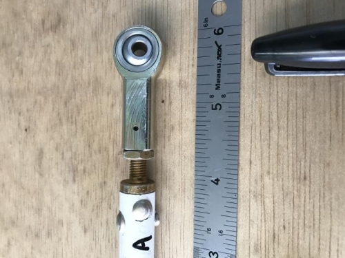

W-818 pushrods as shown in DWG 15A.
OK worked out how to do this effectively.
Use a 1/8" Drill to make hole. Use #11 rivet. Buck using gun and bucking bar. Works very nicely indeed.
Rivet Formed
Rivet Formed
Length Adjusted
