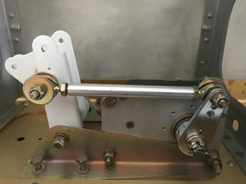

Brief Description:  Installing Roll Servo - Right Wing
NOTE: From Garmin Figure 11-9.1 - "Stop Bracket Overlapping Servo Bracket is Permissible". This seems usual but is clearly sdtated in the manual. After speaking with Stein Air, some reviews on the web and consideration, I do not think this is needed and will not install it.
1 - The control stick and pushrods have limited movement range.
2 - Ido not like the idea of the overlappin of the bracket.
Servo and Pushrod (Top View)
Servo and Pushrod (Side View)
