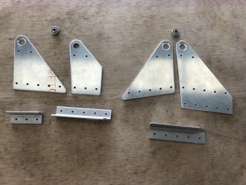

Brief Description:  Install Aileron Brackets to Rear Spar
Install W-413L&R and W-414L&R aileron brackets on rear spar. See Builder’s Manual section INSTALLING THE AILERON BRACKETS in the RIVETING THE WING SKIN Section and DWG 13A.
Assemble the W-413 and W-414 Aileron bracket assemblies as shown on DWG 10A. Install them on the rear spar by lining up the matched holes, drilling, deburring, and riveting.
Continued .... Prepared edges and deburred ready for priming.
Aileron Hinges Prepared for Priming
