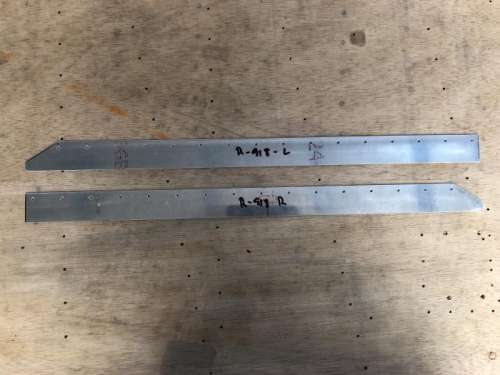

Make the R-918 rudder bottom attachment strips shown on DWG 7 and clamp them in place. Drill them to the skeleton, using the existing holes as drill guides.

R-918 Prepared
R-918 Prepared
R-918 Prepared
R-918 Prepared
