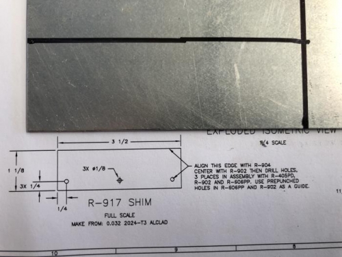

Fabricate R-917 Shim per DWG 7.

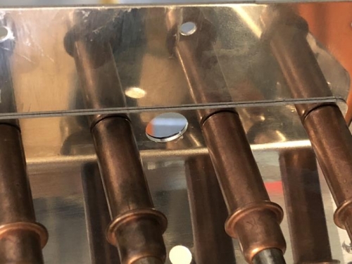

Cleco the R-904 bottom rib and R-405PD rudder horn to the R-902 rudder spar. Slide the R-917 shim into place between the rudder spar and rudder horn and drill to #30. Use the pre-punched holes in the spar as a guide.
-> The shim fit really well into place.
