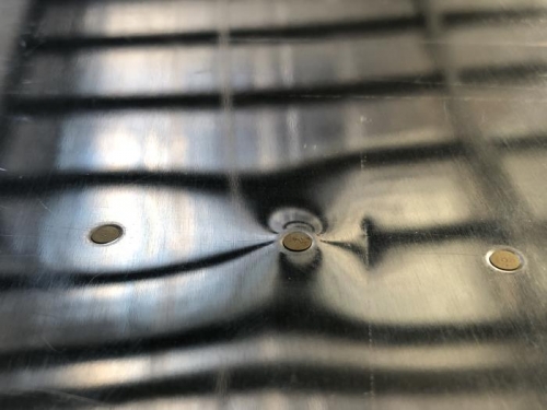

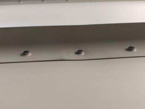

Rudder - Rivet miss
I was distracted for a single rivet. Back riveting and this rivet missed the backing plate just slightly.
Going to leave and build on. Other have done similar in the past and has been OK.
I will consider removing this stiffner, Smoothing the skin and aplying a new skin.
Slight bend in stiffner
Slight distortion in the skin
