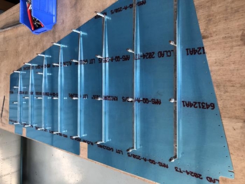

Pre-punched holes in the R-915 rudder stiffeners match corresponding pre-punched holes in the R-901-L and R-901-R rudder skins.
Trim individual stiffeners from strips consisting of two stiffeners. See diagram on DWG 7. Shorten all the stiffeners (except the lowest) by trimming the excess from the forward end. Use the pre-punched hole pattern in the rudder skins to determine the correct amount of trim. See note on DWG 7.
Before you begin actually drilling stiffeners and skins, be sure that you are placing the stiffeners on the inside surfaces of the right and left rudder skins. Study the exploded isometric view on DWG 7.

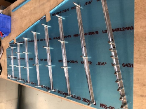

Match drill the stiffeners to the rudder skins. Having a tabletop you don’t mind drilling into will make the job easier. You can drill through the part right into the table. A cleco run into the hole in the table will not hold the part up off the surface.
Disassemble and debur the holes. BE VERY CAREFUL deburring the thin R-901 rudder skins -- it doesn't take much pressure or over-enthusiasm (one turn is usually plenty) to ruin a hole in 0.016 aluminum. You do not want to be left with a knife-edged hole when you are done.
Stiffners made
Stiffners made

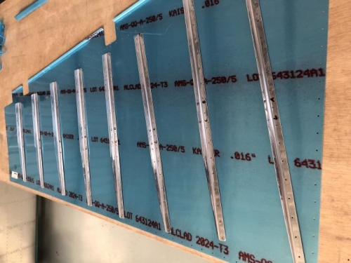

Right skin
Right skin
Left Skin
Left Skin
