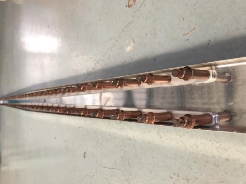

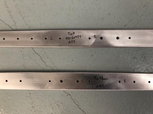

Use a file or Scotchbrite wheel to "break" the edges of the HS-609PP (See Sec E-E). Lay the HS-609PP rear spar reinforcement bars inside the HS-603PP spar channels and check to see that the faces rest against one another when the holes are aligned. If the bend of the channel tends to lift the edge of the bar, use a coarse Vixen file to round the edge of HS-609PP to fit. Round the ends of the HS-609PP bars as shown in Rear View.
Smooth the edges and surfaces of the HS-609PPs to a satin finish equivalent to that left by 400 grit wet/dry sandpaper, removing all the milling and file marks (See “Edge Finishing”, Section 5.2).
The pre-punched holes used to attach HS-603PP to HS-609PP are slightly undersized, and must be "final drilled" to the correct size. Cleco and drill every second or third hole, drill #30, then move the clecos and drill #30 all the remaining holes.
Carefully locate the holes that attach HS-708 to the rear spar assembly (it is the eighth hole from the end of HS-609PP) and enlarge it to #21 (See Rear View).
HS-609PP Prepared
HS-609PP Prepared
Rear Spar Assembled
Rear Spar Assembled
