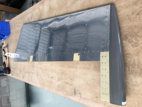

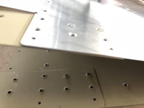

Rivet E-713 to E-701, two rivets on the top and two rivets on the bottom (assembling this way eliminates the need for blind rivets).
- This was an easy step and preferred to putting in blind rivets (Image 1).
Loosely place E-714 in place nested inside E-713 with screws partially inserted.
Insert the elevator skeleton into E-701-R/E-713 beginning at the front end of E-703/E-704 and then rotating the root end aft into proper position.
Cleco and rivet E-701-R and E-713 to the understructure.
Finish attaching E-714.
E-713 to E701
Complete 1
Complete 2
