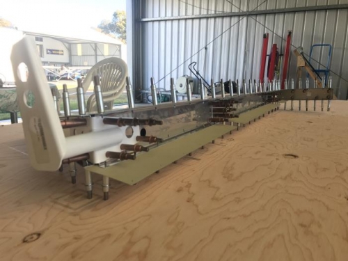

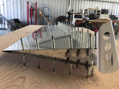

Elevator Right - Attaching the Elevator Horn
Cleco the E-709 root rib right to E-702.
Final drill #40, E-709 to E-702.
Cleco E-701-R to the understructure. Note that E-701-R lays on top of E-713.
Remove the clecos connecting E-709 to the E-702 then cleco and drill the WD-605-1-R elevator horn to E-702 and E-709.
