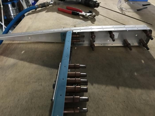

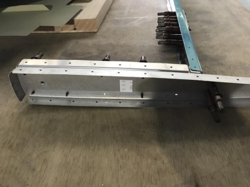

Elevator Right - Counterbalance Ribs
Prepare the E-703 end ribs and E-704 counterbalance ribs (See “Edge Finishing” and “Fluting”, Section 5.2 & 5.13).
Cleco and drill the E-703 end rib to the E-704 counterbalance rib then cleco and drill them to E-702. Remove the ribs from the spar.
